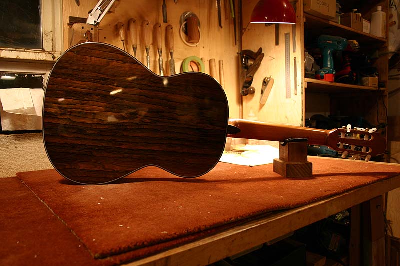

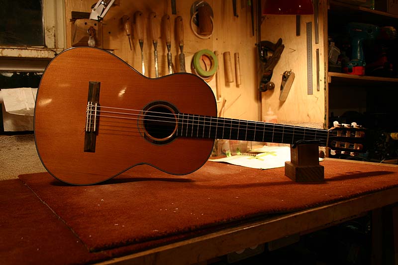

I lurk more than I post but here are a few shots of my first classical build:
The Ziricote back:

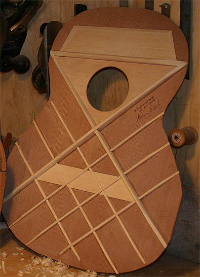

The bracing pattern for those who are interested:
As an aside, I brought this guitar around for some players to test and get their impressions. One in particular, a flamenco instructor predominantly, managed to gouge the French-polished shellac a few times near the soundhole, even though I forewarned him to be careful. He felt no remorse about it. Merely shrugged his shoulders and said, "I'm a flamenco player, what'd you expect?"
How do YOU deal with this and the damage caused by test pilots? What if I actually was trying to sell it?
It's ONLY my own instrument, BTW, so I'm not quite as peeved as I may seem. Thoughts?

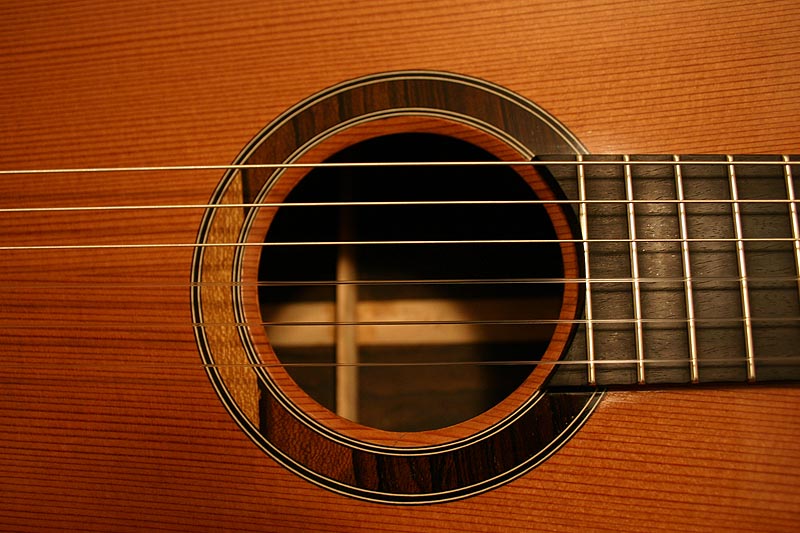

Man that's a nice guitar! Can we get a closeup of the rosette?

That is thew wonderful thing about FP finish. The repair is the same as you put it on. Body, glaze and buff.

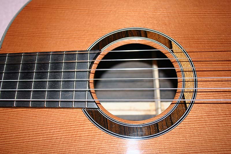

Thanks guys, I'll take some shots of the rosette tonight. Basically, it's another piece of Ziricote bound in black and white.

Warren, I know some luthiers of note keep handy an envelope full of those
static-cling decals for just such purposes. They cut them out go around the
perimeter of the sound hole and protect the top on either side of the strings.
When putting the decals on it also sends a message to the player that
keeping the instrument blemish-free is being taken seriously. Good luck on
the repair!

How did you decide on the bracing pattern?

I followed the pattern that Sergei de Jonge has been using for some time. It seemed to avoid the pitfalls of the distorted lower bout that I've seen in quite a few older fan-braced classicals.

Very nice effort! Congrats! Can you attempt to describe the sound to us and how you think that bracing pattern may have played a role in the overall sound?

Firstly, it's way too early to tell. Three players commented on this right away. That it sounded very new. "Play it and come back in a month.", they said. I'll place it in front of the speaker and blast Rachel Gauk and Sylvie Proulx at it for a few weeks. I'll expect the guitar to play as well as them afterwards.
Sergei and Joshia use the same pattern so maybe this review is appropriate:     http://www.guitarsint.com/detail.cfm/id/431
I'm not good at judging the sound of nylon-stringed instruments. To me, mine sounded like everything else being built in the shop at the time including the aforementioned classical from Joshia. I would call it balanced but I think there's a lot more bass to come...

As far as people gouging the french polish... Everyone thinks they're being careful about it. Everyone. I see some guitars I've made that look like a bear played them after a year or so. On the same token, I got to see one about a year old this weekend (the customer dropped it off to have side dots installed) and it looks as good as the day I sent it to him.
If you French polish, you just have to live with the fact that you may have to be doing some touching up. This is a lot easier to accept if you send it to the customer and at that point its perfect. And a lot more difficult if you leave the house with it looking perfect, bring it all over town to get players perceptions, and then have to touch it up before its final destination.
I don't let anyone touch my guitars between the time I'm finished with them and the time they're sent. More headache then its worth. I'd rather let someone else play it in the white.

I typically use "kling-on" brand removable guards when people are playing to prevent gouges...they are easy to use and prevent most but not all abuse.
Note that I use these for guitars that I have built but are not spoken for our are part of my collection. Just as Joshua does, if a guitar is for someone once I finish it, no one handles it before it ships.
In general I prefer to keep guitars that are built but not shipped unfinished. That way if I need to make any corrections, touch up anywhere where someone was not gentle and clean up before finishing. If it is unfinished, I have no problem with playing my guitars.

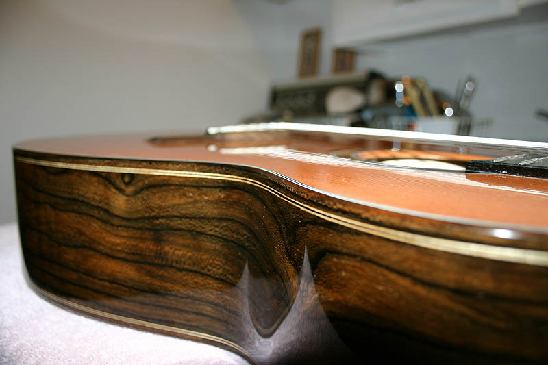

Here's the rosette, as promised and an overlit look at the waist (don't worry - the knots are zapped up).
